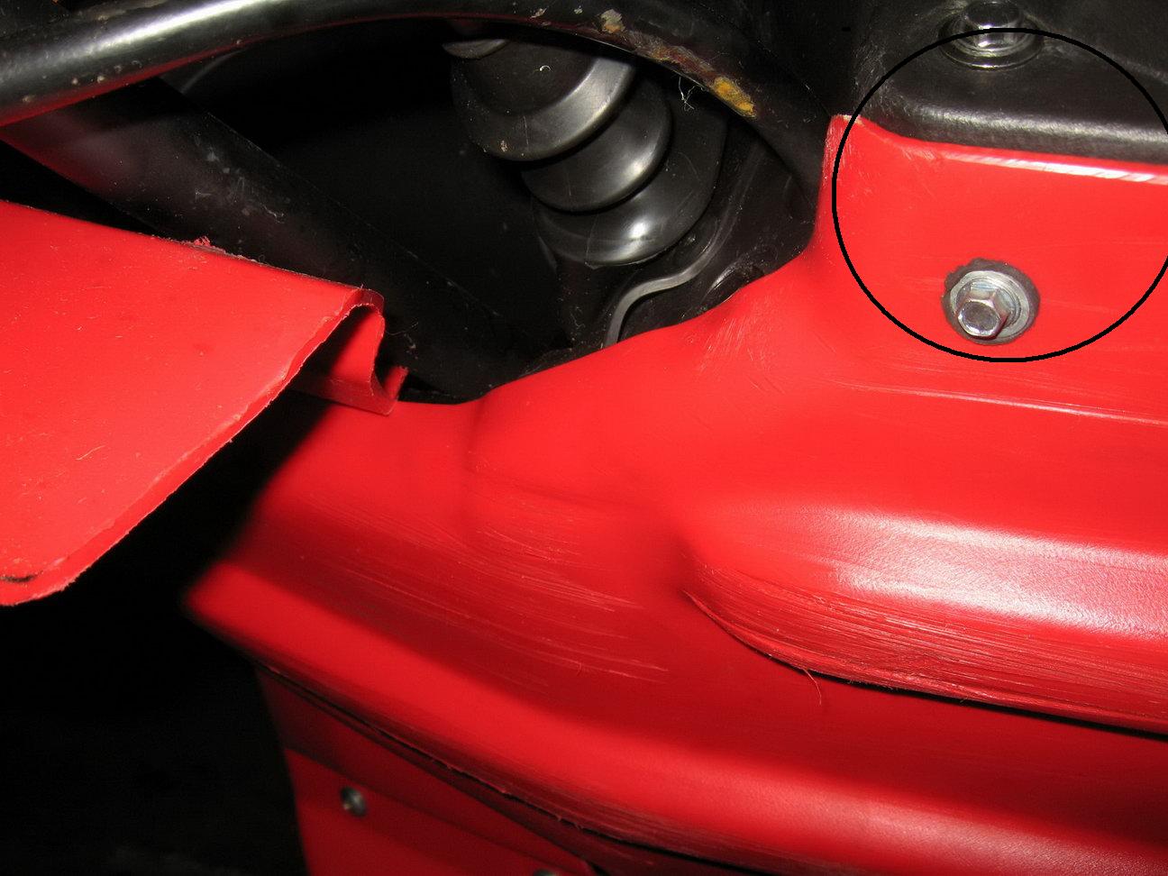

The problem of freezing the ice long been familiar - to reduce the amount of ice was installing additional bolts - Pincher protection to more tightly to the body of the snowmobile. (IMG_2725)

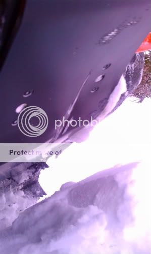

In my opinion the reason for freezing a large amount of ice because of its falling into place is shown in IMG_2728
Snow falls under protection - there on the dripping snow from the motor and it turns into ice.
Need than to close this place. That want to try the next exit.
