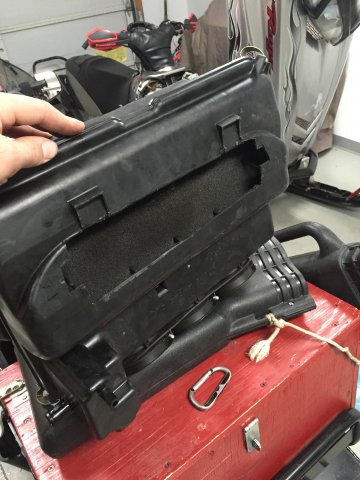

Ok so cleaned carbs and got it almost back together and i decided to check out the air box since I cleaned everything in the carb and I discovered something. I can't believe I didn't see this before! I have a huge hole cut into the bottom of the air box . Stupid question but would this cause my problem that I'm having? Lol here are a couple pictures.
Metallicat
I doubt that would hurt your performance to the extent you described. I once had a torn carb slide valve bellow, and my sled ran like crap. What are your rpm's at WOT? You should be around 8500.

Ok so cleaned carbs and got it almost back together and i decided to check out the air box since I cleaned everything in the carb and I discovered something. I can't believe I didn't see this before! I have a huge hole cut into the bottom of the air box . Stupid question but would this cause my problem that I'm having? Lol here are a couple pictures.View attachment 112283View attachment 112284
Without going down and looking I think that the size is the same as stock. If memory serves, there's a lip that goes all around the bottom of the opening....yours look like it has been cut off.
Vector88
- Jun 23, 2007
- 64
- 808
- Happy Valley Goose Bay
- 2005 rs vector 159
Yup it's been cut off. Found it out last night. Would that be causing my problems?
IMO.....no, not at all.

Ok went for a test run now I can get it up to 8000 rpm with alot more throttle response but not perfect yet. All I did was cleaned carbs last night and tried my buddy's stock secondary. So I'm guessing the rest of this is probably the airbox. Well it's worth a try and seeing the plastic sliders in my buddy's secondary were really worn out lol
Why do you think the rest in in the airbox?

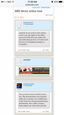

Because of the huge hole in the box. Jetting is all stock so it would run worst don't you think? I seen a post on here about the vector airbox mod and the guy said its a absolute no no and will cause a lot of power loss unless the guy is lying? He's a TY 4 stroke God on here so I'm guessing he knows what he's talking about. I took a snap of the page in the pic below . Let me know what you think. Link is here if you can't see the picture. http://www.ty4stroke.com/threads/2005-vector-airbox-mod.36303/
