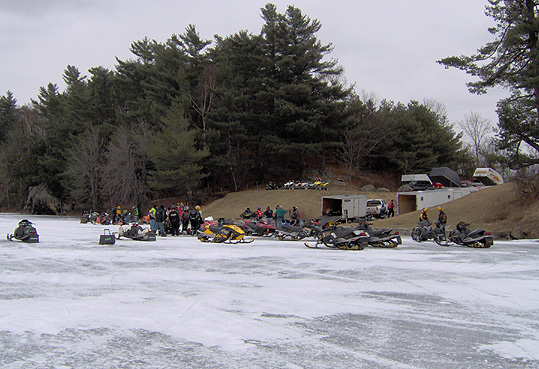

O.K. here we go.
Tuesday 3-21 I took the vid(see link first post) of BA coming down the lake and hitting 120 mph on the gun.It does show 120 but its very hard to see because of the sun glare.Sorry.
I took the pictures at the lake except the one of the RTX and GT with me standing beside it.Nice pic BA,THANKS!!
I took these pics in part to show that most of us are serious about this
radar stuff when we want to be,even though its still playing around and for fun.It doesn`t matter if someone and their sled is faster.If I wanted to be the fastest I would have the biggest turbo out there on race gas,stud the thing up and have at it.
The sleds and trailers you see are only about half of what was there.
Big numbers put up for the shorter run that was set up.660'.
