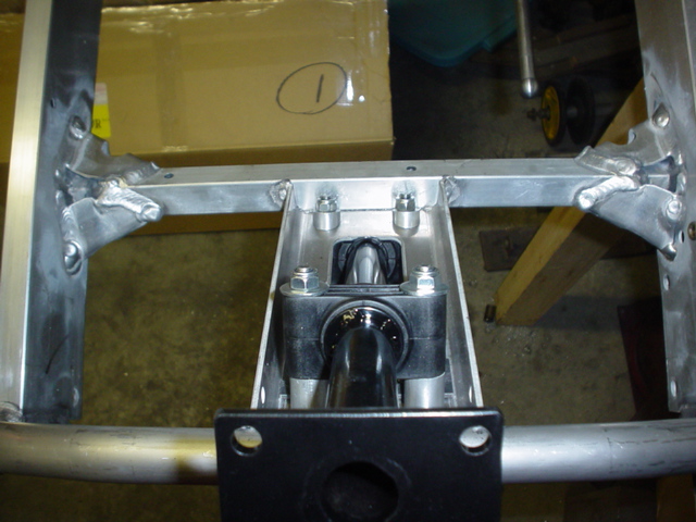

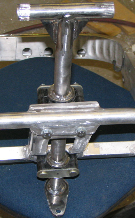

This is how I did mine. I modded the steering hoop. If you can weld aluminum its pretty staight forward (no pun intended)

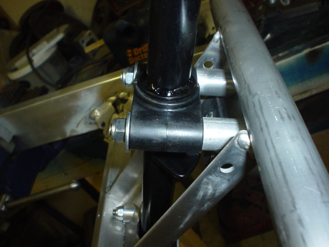

ted it makes your rx1 into apex style riding position moves your bars forward around 4 inches & puts you in a more natural riding position.the kit includes bolts new angled bushing & a new post made of cromoly & powder coated whatever color you want.you can get ahold of him on snowest forum his user name is wildchild.i will see if he dont mind me putting his email adress on here for guys to contact him.he also makes a-arms & some other light weight stuff for the rx & apex. here is some pics of the kit.

Here's my Vector. I had t trim quite a bit off my cowling to allow it to clear the bars and brake lever when opening. Plus, the riser hit my guage so I temporarly relocated it to the top of my headlight pod.
I'm not pleased with the asthetics but it does make the sled better for stand up & agressive riding. Huge difference actually. I also have to run a low wind shield so that sucks a bit.
