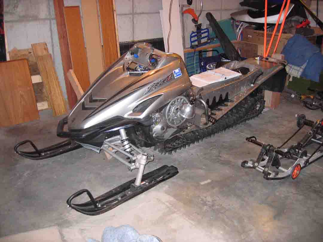

freelheeler
drivers are out !!!!!!!!!!!!! holy crap 3 nights i'm sure i've tweak'd the thread on the end of the shaft i'll just have to deal with it. ended up cutting out the rivets on the collar and took out the whole things, at least i can get it to the shop to press on the drivers, they've got a bit more mechanical advantage.
any home made press options or ideas for removing and installing drivers?? i've always taken them to the shop it's nice having a no brainer phase in the project.
also took off the stock tunnel extension and rear drop brackets. nearly broken a toe when it came loose, there's was some serious weight compared to the hartman extension.
started working on the m7 skid bogie wheels, torque relocation, and anti stab. i'm optomistic!

freelheeler
installed the wildchild rider forward kit this weekend. not to bad a setup i'm switching to a set of apex handlebars which required a bit of tweaking but for the most part should work fine
a note to those embarking on the mod the diameter of the old post hole is 5" i was able to use an old 5" lid as the base and aluminum rivets to hold it. the clearance of the handle bar base isn't too bad either. just waiting on risers

freelheeler
took the weekend off to antelope hunt and wait for more parts... could have used the sleds we were definitely pushing snow with the truck bumpers heading over the passes.
i've installed a 6" riser w/ apex handle bars and ncluded a lefty throttle ended up cutting a wire in the grips and had to splice and dice?? just a bone head move. the handwarmer off the apex have different connectors so i need to figure that out? the apex bars are significantly straighter bars and the 6" riser puts them about where the stock bars would be with a 2" rise?? got them for free with new grips warmer and bar ends i'll try'em, the bars are definitely high but i got the 4" riser as well and will see what works.
also bought some fog lights and hand guards, it's real tough fitting the the lefty and the mount for the hand guards so i'm thinking of keeping the stock light and cutting the windsheild down? actually that's why i was cuts into the grips. also waiting on some aluminum drop brackets for the skid, it's pretty much ready for install, the holtx relocation kit and anti stab wheel and wheel kit are installed.
still haven't pulled the trigger on a track but i'm back to thinking the maverick will work just fine...

freelheeler
nearly forgot... had the new avid drivers pressed on this last week and the dealer had to cut the bearing off they broke there puller trying to get it off. it's good to have a bit of adversity.
started feeling a bit of regret going to the 3.0 vs 2.52 extros, knowing the camo 162x16x2.25 2.52 ($650-)was availible. but with the sale of my old drivers and track it shouldn't be too bad. new maverick ($424)
