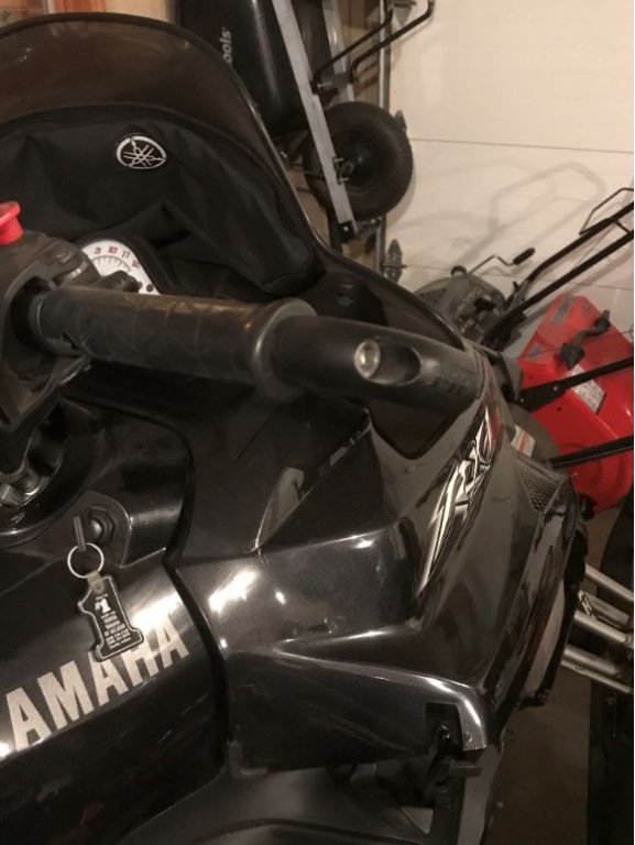

I have BJ Hookers on my RX-1:

RobX-1, You must be a racer with those 90 hooks!! Nice looking sled
