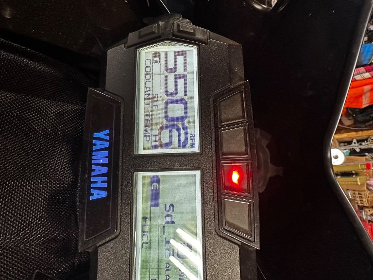

2017 winder 240 hurricane tune . Bunch of other goodies and 10,500 ish miles . Been in the garage since November fired up fine when I changed oil back in November . Went to fire it up today and got sd12 and tach reading 5506 rpm. My research is telling me I have a bad stator/crank sensor. I will do the appropriate diagnostic I wasn’t able to do tonight . Just wondering what any of you guys have to say ? Thanks in advance

I would make sure your battery is good first.

Battery is brand new but I will still check it out. Appreciate the reply will be tearing into it shortly . Will update with culprit/fixI would make sure your battery is good first.

Update it was the crank position sensor . Yamaha was back ordered till the end of the month and arctic cat was back ordered till may. Shout out to rmstator in Quebec I had a new stator with the crank sensor within a day . 30 day money back and a 2 year warranty. Likely about a 4 hour job worst part is the 1 turbo bolt on the backside of bracket that goes across subframe and scraping the ole gasket off.

Yes starts and runs fine now. But was a little discouraged after install i turned key on engine off and the cluster was still showing the same code and engine rpm till I started it and all good now.Did you complete the new stator install yet? No starting issues now?
