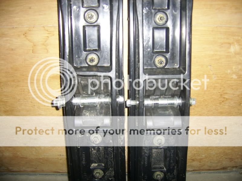

The Powder hounds were bolted on and NO other adjustments were made, therefor they were a little aggressive and heavier steering. But OH man do they float good! I think they will be a good match for the 120x1.75x16 track.
