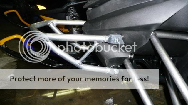

I also have pictures of my newly welded hitch. As I commented before, the factory design was weak and didn’t hold up.

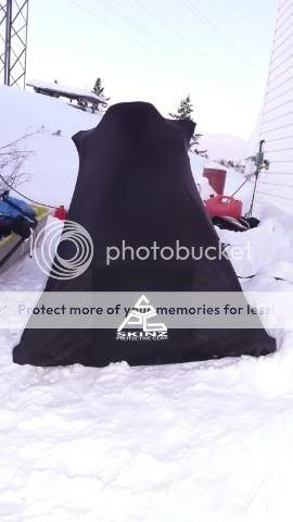

Switching gears – I had put on a Yamaha Cover for my Nytro MTX. It didn’t fit, it didn’t even extend over the rear bumper. It was a poor attempt at providing a cover for the sled so I took it back.
Sled Solutions offered a cover for the MTX, so I figured I’d give it a try. It took awhile to get it, but it is one hell of a cover by the looks of it. Will it withstand the test of time? We’ll find out. It really does stretch to fit over the sled though. It took a couple of applications and letting it sit overnight partly on the sled to stretch accordingly, but it fits awesome now, and over the entire sled, front to back, including my tour buddy and my rear rack and hitch!
Again, these pictures are from when I first started to put it on and stretch it. I’ll take more of it fully applied over the entire sled later.

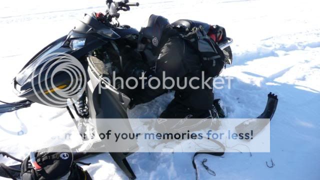

Something went horribly wrong…where’s my sled???
Aftermath…

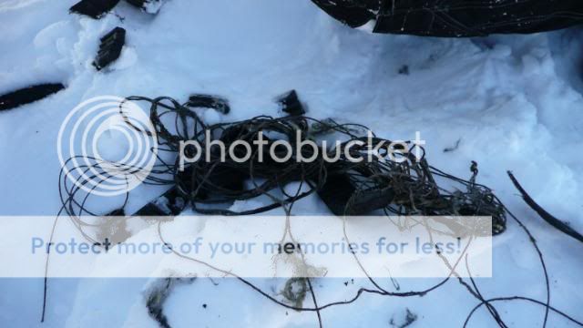

Now let’s rewind…to when the trip started…with this:
Yes the fantastic explosion of Nate’s belt…

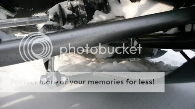

First, the usual…look at the snow buildup. This is pathetic and it really is the worst thing about this sled…
Even the reverse gear shift freezes with ice…not good.
Even when I block holes in the cowling, snow still finds a way in!

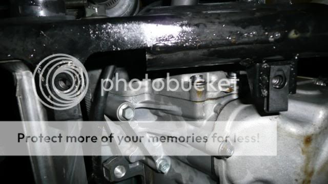

I found a small coolant leak but that was easily solved (last I checked) with the tightening of a clamp…

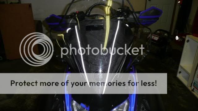

My windshield bag finally came in though – the one that works with the tall windshield…its a Velcro install around the speedo…not sure if it will hold up but the bag is actually pretty awesome for spare mitts and stuff, I’ve used it every ride since the install…

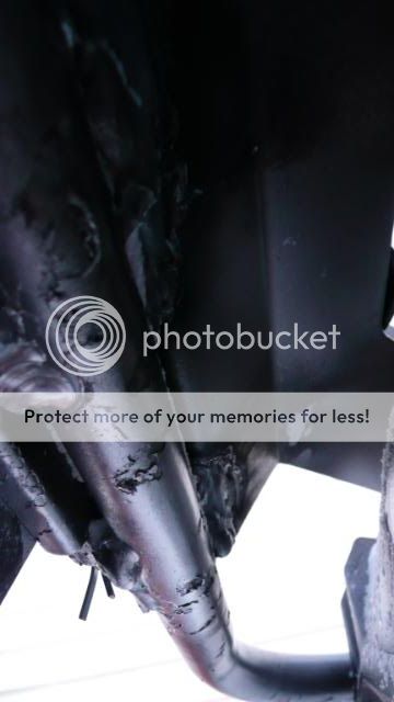

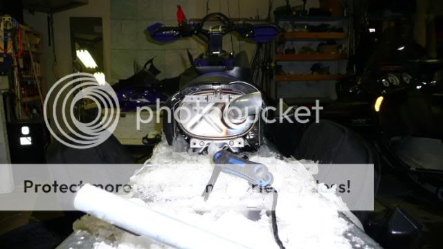

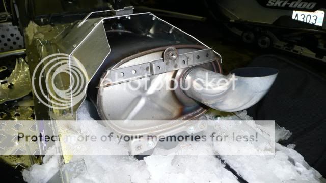

I removed the tour buddy to have a look at it and see how it was doing. I was suspicious of the heat from the muffler causing the tour buddy to warp, but there was no damage at all from heat around the muffler – there was however some wear on the fuel lines because they were pinched up against the heat shield that surrounds the muffler…I wrapped them up and padded them with heat reflective tape…
The exhaust turnout on my sled started causing problems for my tour buddy. The heat was causing the tank to bulge…
I decided to remove the exhaust turnout and redirect it upwards to solve this problem. Will it collect materials like snow inside? Not while the sled is running, yes while the sled is off, but I don’t think it’s a big deal, it gets blown out as soon as you fire up the sled.

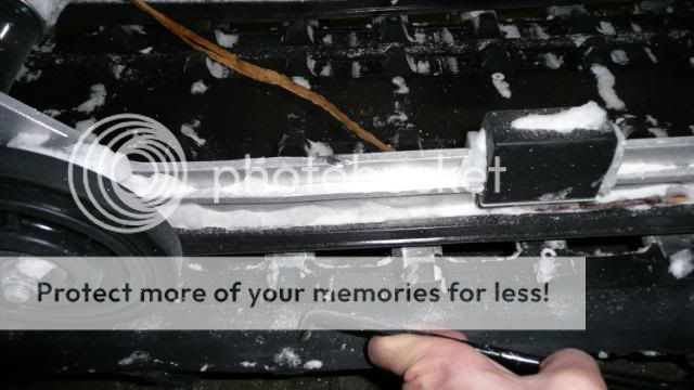

With the installation of ice scratchers from earlier in the season, they seem to leave their mark on the rails…

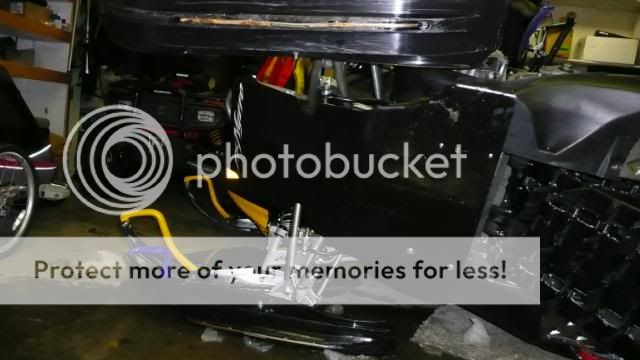

Okay, the bumper was easy to put on. The Floatation Plate was another story. It comes pre-drilled for installation, and the way this thing installs is pretty wonky if you ask me and I wasn’t impressed, everything seemed like an afterthought on this thing so that it could hit the market in time…hmmm…that happens a lot.
I had to remove the belly pan, only to find that the front of it was busted from ice buildup…
Those plastic push-pins are junk, I can’t believe plastic is holding up the belly pan, and I can’t believe the belly pan is plastic to begin with! It’s surrounded by gaps that snow gets into and causes problems. Frozen steering, busted steering boots, belly pans hanging down 6 inches….come on…these designs are for groomed trail riders, not powder riders.
Whaa whaa whaa. lol

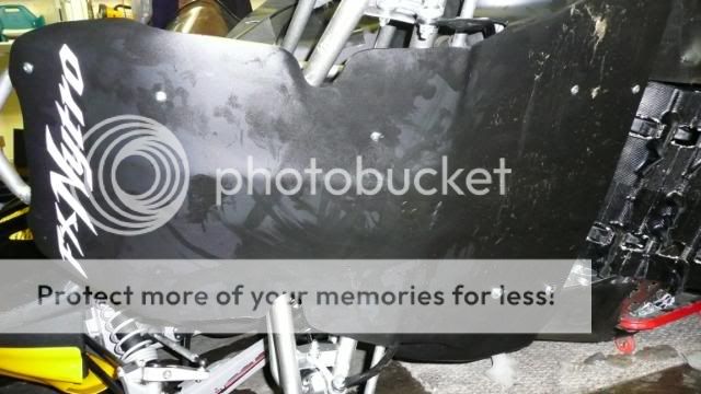

Here’s the floatation plate…
I was swearing my head off (bad day I guess) because NONE of the pre-drilled holes in the floatation plate lined up. Why? I don’t know…you tell me. Is it because they were off? Is it because the front frame of the sled flexed too much in 4000 km’s of riding? One spindle is 3mm further away from the frame than the other spindle. Maybe I hit too many trees.
Regardless the instructions were not very good. The way they want you to do it is hold stuff in place and use a marker to identify where to drill a hole – yes, you gotta drill into your side panels.
That didn’t work so well, so I took everything off the sled and set it up on the floor to align it and drill it in place…
So guess what replaces a few push pins? Threaded circlips. Try lining these up. What a pain…they slide around when you are trying to thread your bolt in…
Anyway after a lot of yelling at myself outloud I got the stupid thing installed…
The front of it is held on by clamps…not really that good in my opinion…but Yamaha’s other skid plates are the same install around the bumper, like on my phazer.
One thing I will give credit to the designers of this floatation plate for is that it covers under the clutches and the oil reservoir – that’s panel to panel, not just the belly pan. That’s the way a skid plate should work, what good is it if it doesn’t protect vital components other than the motor?
So I looked at it thinking, yeah…it will accumulate snow in the front A-arms, and it will likely build-up snow and ice between the belly pan and the skid plate itself, but the one piece design of it may not only prevent snow from coming into the engine area but it really does look like it will help in floatation when carving and in deep snow.
What’s the verdict? I have an answer – more to come.
A couple of weeks ago I hauled the Nytro into the garage for some routine maintenance and to check things out…and I found a lot.
It’s tough to keep my frustrations calm because I seem to have the same issues with both my Phazer and my Nytro, and what seems obvious to me is definitely not obvious to those who have designed these units.

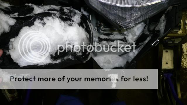

They fill with snow from where the bracket goes into the back of the bag…
The zipper let go on the one bag and I lost the contents (my snow bungee!)
The bags themselves started ripping where the mount goes through them. Even the bracket itself was bent from ice buildup getting in behind it.
I decided to remove them both because they collect snow and with a broken zipper it was pretty useless. I could have left the brackets on and just put the fuel cans on there but at 5 liters a side I didn’t think it was worth it.

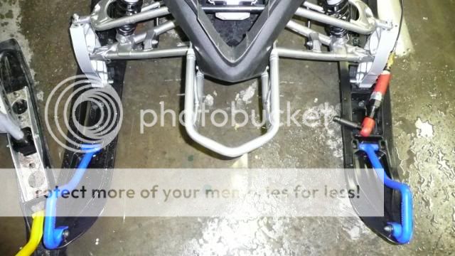

Remember when I bent/broke my bumper? Well the new one finally arrived with Yamaha’s Floatation Plate! A few have questioned if the plate would work, and whether or not it would just scoop up more snow.
Beefier bumper? Didn’t weigh anything…

After 500 km’s of testing with the Yamaha Floatation Plate, it too receives a failing grade.
Why? Here’s why:
The damned thing fell off!!
So what’s the problem? How about the age old snow and ice buildup. Am I providing enough proof that this is a major problem with these sleds?
We were powder riding, I stopped to talk to Bruce and he pointed out that my skid plate was falling off. There was so much snow and ice build-up between the belly pan and the skid plate that it pushed the skid plate right off in a variety of ways…
On a couple of bolts, even with washers that I had installed, they punched right through the skid plate from ice buildup. On a couple of others, you know those threaded circlips I showed you? It took them right off the sled, space, bolt, circlip and all – still attached to the skid plate. In other spots, the clamps I showed you in the front? They busted clean off!!
Like come on – this is crazy! Obviously I’ll be going to get my money back and return the skid plate.
It was hanging by one clamp when we seen it, so I removed the clamp and put the skid plate on the back of the sled. I thought I could make the thing get air!
So what’s next? Right now I’m waiting for the belly pan to fall off. There ice buildup between the motor and the belly pan, then ice buildup between the belly pan and the skid plate, and ice buildup between the side panels and everything else on this sled’s front end.

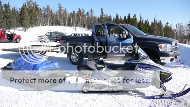

Hey, look at the DOO owner who’s having fun at my expense lol

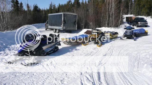

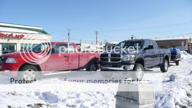

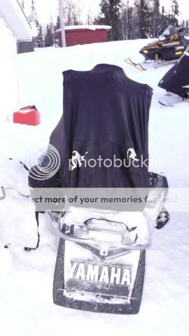

The trucks were loaded and ready to go;
You can see my Sled Solutions Skinz cover. It pulls further over the rear bumper on the MTX. So far so good with this cover, seems awesome, just have to find out if it lasts the test of time/durability.
