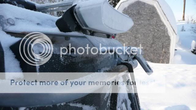

Another testing issue to report – The Hitch offered by Yamaha (currently on hold?? Not sure)
I have been able to put roughly 500 km’s (300mi) of towing onto this hitch and unfortunately it gets a failing grade.
Yamaha was generous in sending me a hitch early in the season for testing and feedback. You may recall my initial comments after it was installed. I though that the 4 spot welds on the bumper were too weak, and that the base of the hitch should have been welded along the bumper, not just in four spots.
I was right.
During our camping adventure this past weekend, we were riding over 2 foot drifts on the lakes that were solid as cement - but despite the rough snow conditions, we were averaging 20 km/h (12mph) which isn’t fast at all, so we weren’t beating up on the thing.
The welds simply aren’t strong enough – and the bumper carries more towing weight than the upper design of the hitch which connects into the tunnel.
Here are some shots of the breakage:
You can see the spot welds…
So, the folks at Yamaha should redesign the hitch to be welding across the bumper, not just in four spots, and it will handle any load.
I’ve had the hitch welded to the bumper, and will get pics of that next ride out.
