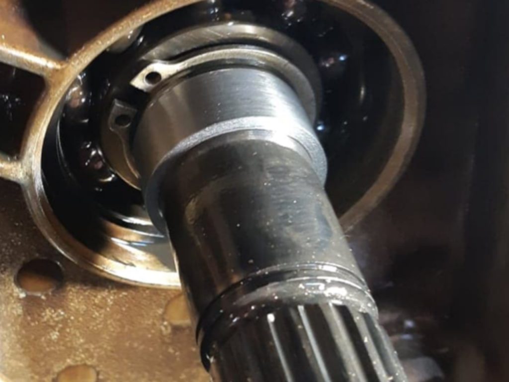

Is this how the shift fork rides on gear, the assembly came off when I took off cover, my dumb #*$&@ didn’t take out the gear that rides off solonoid , and pulled the top gear off, along with shift fork. And there was a washer on the inside of case. That goes on the middle gear correct?

Here is a picture I took before I removed mine.

Yes - the washer is on the middle gear
Be sure to push the gear with the shift fork onto the back gear. They fit tight when reassembling. They will click together.

Ok. ThanksYes - the washer is on the middle gear
