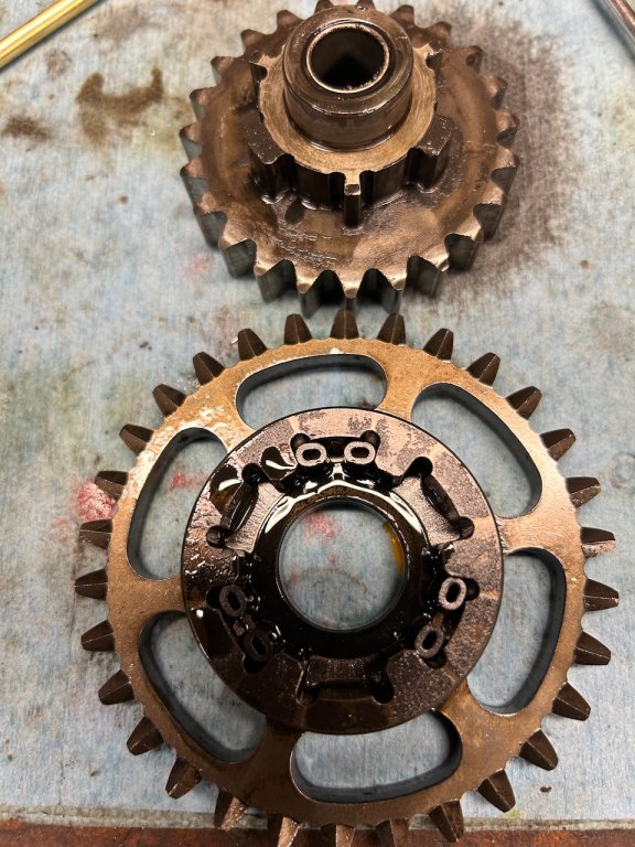

Not sidewinder but I have 28800mi on my Viper with original pads. One thing to watch other than TopGear bushing and Tensioner bolts is the rubber cushion between top reverse gears mine was disintegrated last season. Out of stock. Found a used one and put in. Something to look for that I have overlooked in past. Pull those two gears apart.

Yes I just replaced mine last season as well.Not sidewinder but I have 28800mi on my Viper with original pads. One thing to watch other than TopGear bushing and Tensioner bolts is the rubber cushion between top reverse gears mine was disintegrated last season. Out of stock. Found a used one and put in. Something to look for that I have overlooked in past. Pull those two gears apart.

Great catch! I never saw anyone mention that and I forgot too. The cushion shown in bottom gear.Yes I just replaced mine last season as well.

And as for the gear cushion, I can say that Ive only taken that apart but once, and that was when my sled was still pretty new, and my chain had rubbed and caused a bad wear spot on the internal post/nub! I had to tear completely apart to clean all of the metal deposits inside my chain case, gears and chain! Next season's maintenance I'll make sure to separate those two gears and take a peek! Thanks for the heads up!!

Nice mine were torn off and turned inside so now I keep in stock. I just had my nephews apart and his was starting to tear and collapse as well. Good catch cannondale27.Great catch! I never saw anyone mention that and I forgot too. The cushion shown in bottom gear.View attachment 174458

Good to check. I've seen a few with rubber deteriorated, missing little pieces, etc.
