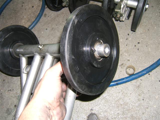

Wheel/shaft removal
How do I remove these wheels and shaft?

Re: Wheel/shaft removal
They are press fit so you will need a puller.
I was hoping to do mine as well but they surprisingly still spun smooth so I left them.
I have just under 5000 km's on my sled and they are holding up good but I am sure sometime down the road they will need some mtce.
My regular gear puller won't work. The "lips" of the puller are not long enough to reach around the back to solid plastic. It will only grab the rubber which will surely tear/rip it.
Any suggestions?
Will
Any suggestions?
Will
Got a hyd. press??
step 1- put a block of wood over the aluminum shaft and whack it a few times with a big fn hammer. this will drive it right through the pressed on wheel.
step 2 - once one wheel is off remove the shaft with the 2nd wheel still pressed on it. put some blocks of wood under each side of the wheel untill the alum shaft is off the ground then repeat step 1
Panterawill said:
Great! A few good shots and came right off.
Thanks
I'll have to remember that, thanks for the tip ;)!
