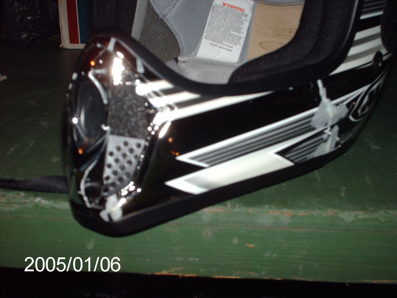

I bought a Troy Lee after that little tumble. I didn't even know my helmet was off for a min or 2. All by myself, pretty stupid. I don't like talking up crashes because that's just saying you're not a very good rider, but this one was pretty hard core. I know it was my fault, but my Rev would've handled that situation a lot better, and i'm sure i wouldn't of even lost it, this one i just threw it away, i knew i was done, lol, but it came back and ran me over! Must not like me much?
