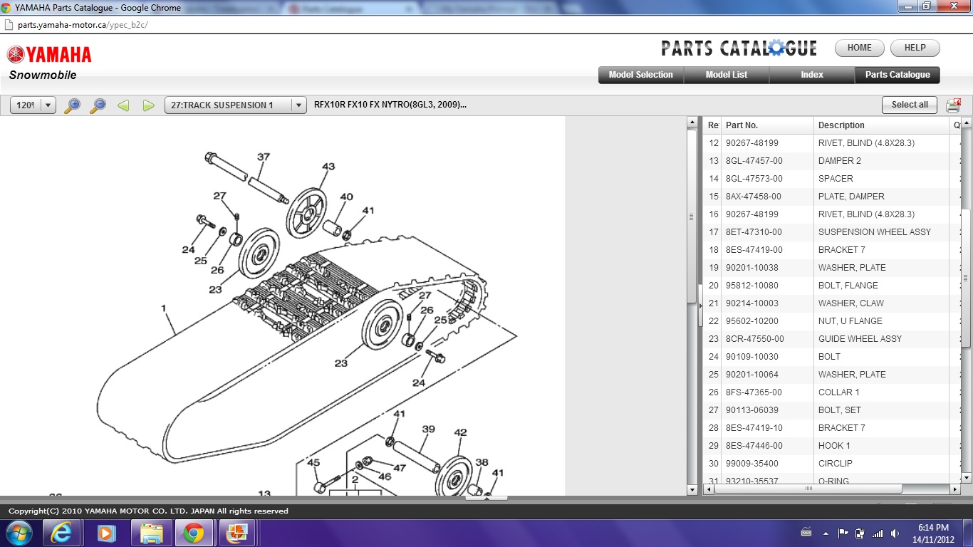

Ok 22 views and no response I need to clarify. So if anyone could measure from part 26 to the ground on there sled that would be a great help. It's the collar for the guide wheel so says Yamaha.

Well from the bottom of that bushing to the inside of the track the flat part and with the suspension lifted to the top I got 11 5/16". To floor will not help i have a cobra track on.
This measure changes when the suspension compresses but I am sure you know that. Hope that helps or call me 204-254-3597 Todd.
Looks like mine is 12 inches from the center of the collar to the bottom of the slide rail, cant do the floor rite now cause she is on a lift now.
Thanks a lot yamahinn, and ToddT. I've got 10-9/16" from the bottom of the collar to the top of the track or the Bottom of the slide rail. TY :Rockon:
