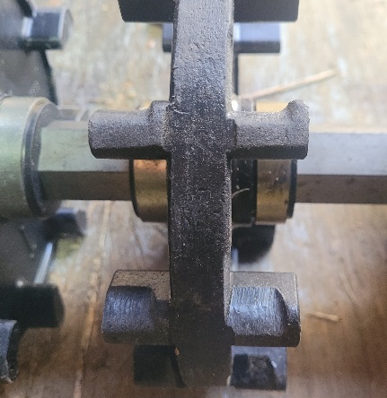

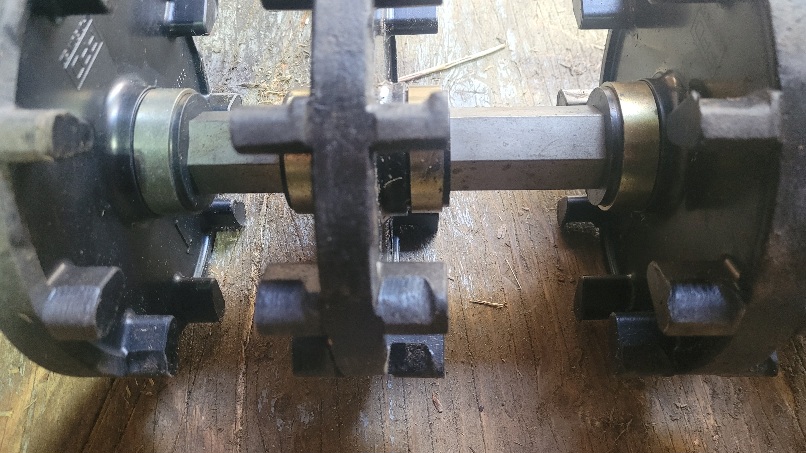

I decided to change my cogs while I have everything apart due to replacing all of the bearings on the drive shafts and chain case.
I noticed that there's a bit of side to side freeplay when you line up the cogs/driveshaft within the track. Is that normal or should there be no play at all?
Thanks
Thanks

Yes there should be side to side free play with cog and window in track.

When you say cogs im assuming you had new drivers pressed on your driveshaft?( yamaha calls them wheel sprockets) you may have a little play side to side to allow for track alignment,the drivers do not fit really tight in the track windowsI decided to change my cogs while I have everything apart due to replacing all of the bearings on the drive shafts and chain case.
Thanks

Thank you, good to know. My cogs wore out a little strangely so I need to see what caused it.Yes there should be side to side free play with cog and window in track.
I haven't yet, I'm going to do then myself. I'm attempting to press the old ones out today if I'm successful, I do not have a press so I'm going to Jimmy-rig one.When you say cogs im assuming you had new drivers pressed on your driveshaft?( yamaha calls them wheel sprockets) you may have a little play side to side to allow for track alignment,the drivers do not fit really tight in the track windows

Wow! Those are super worn!I’ve never seen any that bad, Be very careful pressing those off& the new ones on,pressing can be dangerous & those sprockets take quite a bit of force to remove & install, take good measurements before disassembly,I would check your track really well & make sure you don’t have any bent or missing track clips,
- 5,721
- 4,312
Mark where they are on the shaft.
Take them all off and turn them around.
Note that the arrows have to line up.
When pressing on and off you must press on the hub close to the shaft.

Yeah they are pretty worn and they only have 24,000 km's on em... I bought the sled with 23,000 km's on it.Wow! Those are super worn!I’ve never seen any that bad, Be very careful pressing those off& the new ones on,pressing can be dangerous & those sprockets take quite a bit of force to remove & install, take good measurements before disassembly,I would check your track really well & make sure you don’t have any bent or missing track clips,
I took a few measurements and wrote them all down. Ill make sure to check the track.
I bought new cogs so I won't be using these again.Mark where they are on the shaft.
