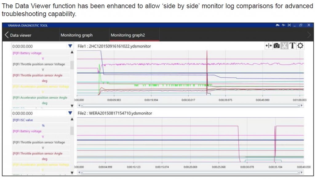

Boys that YDS tool is really a heck of a neat thing but crazy all that can be done. Lets put it this way at PDI if connected and it should be to register the Vin. All values of every sensor while running are stored for future reference in the "Cloud" They can also be printed out for the owner showing anything out of spec. Graphed in real time just like any other Data logger. How far back the thing Datalogs the tech did not know and manual did not show. All the stored info is available to any dealer through the tool and YDS. Its a database which should help in diagnosing issues but it also will definitely show a modded sled. Could there be ways around that. Maybe.

Here is Data logging
Will take a look. 13,14,25,26 are all boost related codes.Great info steve,can you find a code for boost leak,or any code for boost period,cant find any three diget or 4 diget code like Ben said he has seen 1236 looks like our set of codes don't go that high.

Not trying to stray off topic. So this is what I was referring to Steve to see if lag shows itself diagnostically. Probably monitors more than the aftermarket loggers, but I still believe that it should eliminate guesswork and speculation. From Amsnow and Yamaha engineering manager last spring.“The main goal of the 998 Turbo engine was to achieve the ultimate throttle response, or zero turbo lag,” Vizanko explained. “Our whole design and development plan aimed at that as the primary target." "Yamaha’s new engine takes that pressurized air and silently recirculates it into the intake line, keeping that boost pressure on tap and ready for the next time you instantly get back on the gas. This means instant boost, no lag, no funny noises." So according to them, it should not exist.Here is Data logging
