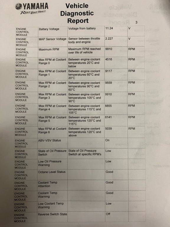

I hope someone will know what i meen. My dealer is working on having waranty work done on my sled for the pramary clutch rubing on the 4 bolts AGAIN cause the did last year. Now yamaha want a machine report that the dealer need to get from my sled. What is this report all about. Thanks in advance for the help.
Well the issue is that your stub shaft has slid inward. This is a common issue and is usually caused by blowing belts at high RPM.
I have no idea what they mean by "machine report" but I suspect it may be some sort of a download from the sleds computer. I am not sure what exactly is saved in the computer but I suspect that it stores parameters such as maximum boost which would indicate if it has been tuned up.
Here is the report Yamaha gets from the dealer. Lots of info there. See my max rpm of 9910! Belt blew!
Any hex coders able to decipher page 5 and sniff out if there is a tune on the sled?

Interesting that they want to know RPMs at different ranges of temps. I thought the ECM limited RPMs until a certain temp was reached. Apparently that is not the case. Not that had anything to do with your situation.
View attachment 153064 View attachment 153065 View attachment 153066 View attachment 153067 View attachment 153068
kinger, did you get any dealer feedback on this yet? Curious what their diagnosis is.
