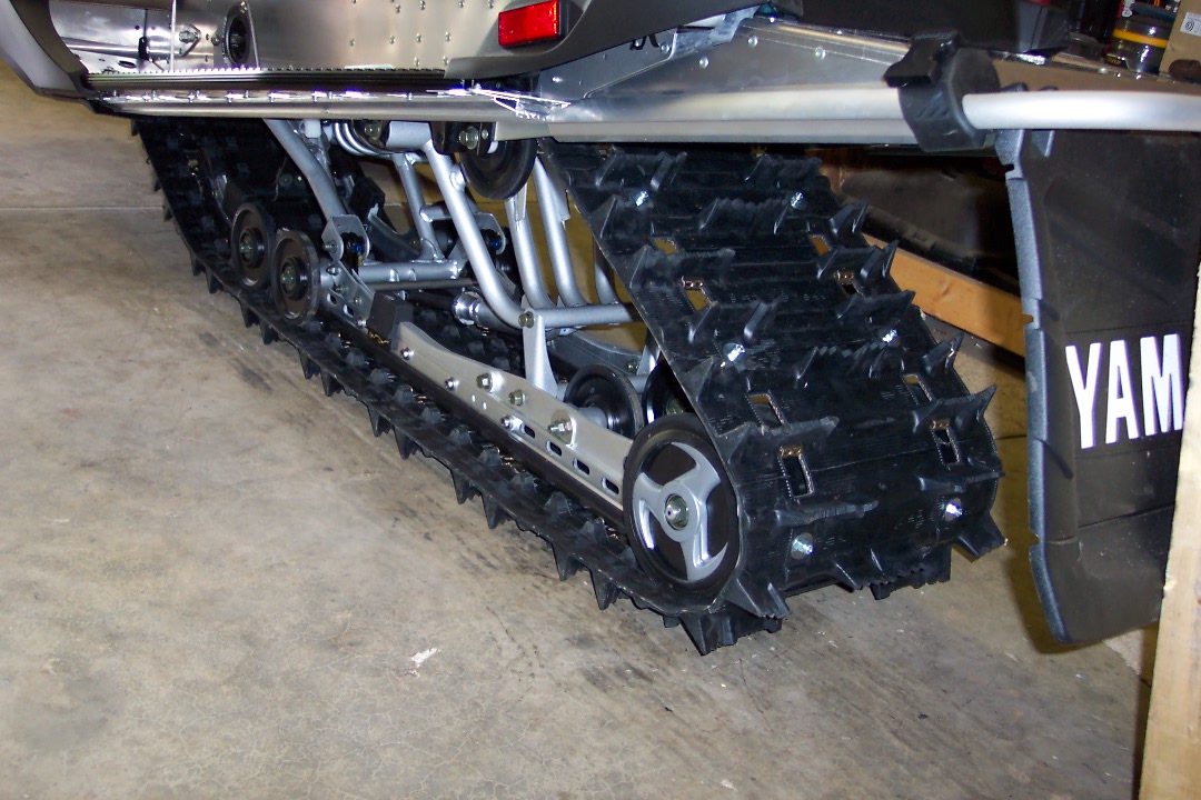

They're nothing but glorified carriage bolts with wider than normal heads. Here's the product:
http://www.startinglineproducts.com/cat ... ductID=143
And an old picture of them installed on my 1.5 inch Intense track....see the nuts on every closed window? Smooth side runs against the hyfax. (click the picture to enlarge). You can clearly see 6 of them in this pic.
