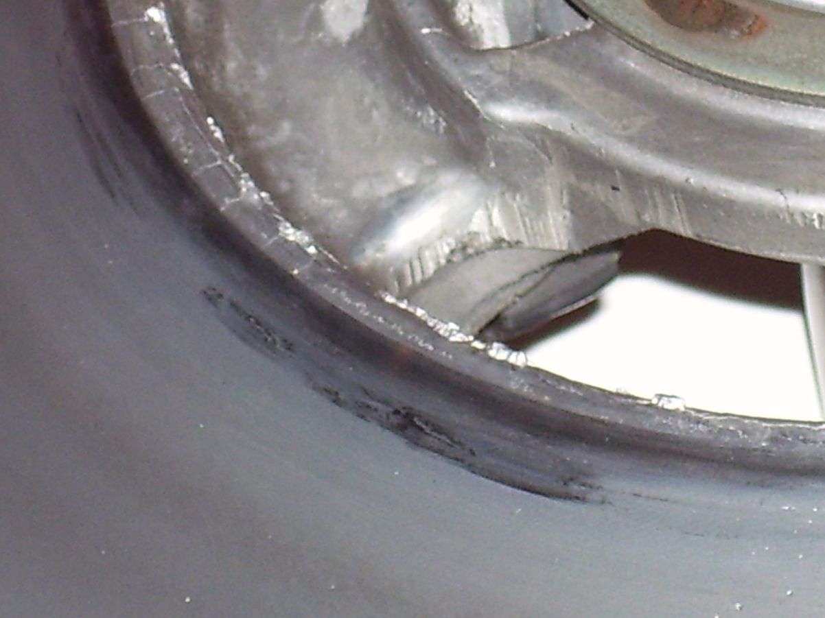

Sorry to detour, but could this be my problem? In the picture at the very bottom of the secondary sheeve there is some major casting imperfections. There is actually some shrapnel pieces sticking out. I just don't know if the belt goes that low into the sheeve to contact them? Is this normal?

zross1 said:Sorry to detour, but could this be my problem? In the picture at the very bottom of the secondary sheeve there is some major casting imperfections. There is actually some shrapnel pieces sticking out. I just don't know if the belt goes that low into the sheeve to contact them? Is this normal?
No appologies, necessary your thread was Hyjacked way off topic.
I can deduce 2 things from the picture, your belt was very worn to the point where it sinks too far in to the bottom of the driven, or there is something allowing it to open too far, both of which can blow a belt.
There should never be belt marks that deep in the driven.
Some aftermarket Helixes allow the driven to open too far.
Those Casting flashings are common and you can take a sanding roll to them to clean them up and reduce stress risers in the driven sheaves.
I do this quite often.
Your welcome to call me to discuss the specifics so we can resolve your belt problems.
