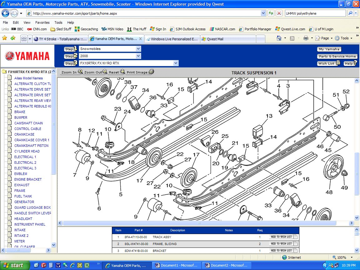

I added the extra set of idlers on my sled. The mounting holes are already in the rails.
You'll need to order 2 sets of the same wheels, mounting blocks, bolts, nuts and washers as found on the front of the rail. If I remember correctly there's some small difference between the left and right side assemblies on the front, but I don't think it matters which bits you get for the rearward set.
I think this setup ran about $200 USD for the whole deal.

I noticed those too. Any idea which one will be close to the one we need?

bracket
part number series you'll need starts # 8ES-47419-20-00

Timeline said:I noticed those too. Any idea which one will be close to the one we need?
I was hoping someone else knew.

arteeex said:I added the extra set of idlers on my sled. The mounting holes are already in the rails.
What would be the advantages of getting this over the 'marginal snow kit'?
I think the marginal snow kit runs in the $80 range and that includes both wheels. That's a bit cheaper that $200. What's the difference?
I've used the first mount listed (157-04) with success on my Vector. You end up having to use an idler with the wider 6205 bearing, so mounting on the inside of the rail really isn't an option with this mount as the wheel will not line up perfectly in between the drive lugs inside the track.
I'm sure that any of the listed mounts would work, as long as you have the appropriate bolts, washers, wheel and bearing size.

Grimm said:I've used the first mount listed (157-04) with success on my Vector. You end up having to use an idler with the wider 6205 bearing, so mounting on the inside of the rail really isn't an option with this mount as the wheel will not line up perfectly in between the drive lugs inside the track.
So you could probably mill the mount to use it on the inside, or were they too short to start with???

That would probably work, but I am pretty sure that one of the other Skidoo mounts is designed for the narrower 6005 bearing. I just don't know which one.

Using the 6205 may be better anyways as the 6005 seem to be harder to get for a reasonable price.
The 6004 appear to be readily available and cheap at Royal. I like using the NTN blue seal with the low temp. grease in it.
I realize it's likely better to have them mounted on the inside but I'm thinking that the 3mm difference may not matter on the outside too much without machining them down. Anyone try this by chance?
http://www.royaldistributing.com/shoppi ... bmit=Go%21

Following up on your question; I first tried the marginal snow kit from Yamaha but it didn't fit the rails of the Nytro, so I went with adding another set of the front idlers. It was a direct bolt-on install that took 10-minutes and that was worth a few bucks for me.
I did this on my REV too with very good results. It seems to me that it even lets the sled roll a little better.
