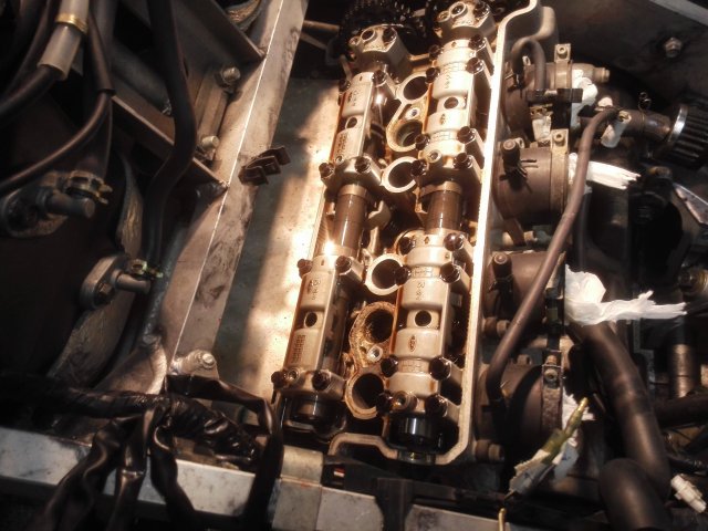

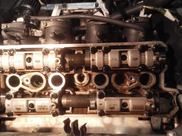

hello, just start to tear down the engine, and i wondered if it could just be the o-ring and the the head cover gasket, if you guys see on the picture it looks like it have been leaking there inn to the cylinder head cover. i was thinking on just changing the o-rings and cylinder head cover gasket.
carsrtoys4me
The gaskets may be leaking, but your problem isn't there. Only fluid under that cover is motor oil.
Sounds to me like a bad headgasket. I have seen the exact issue you describe several times on various cars/trucks, usually a bad head gasket or cracked head.
