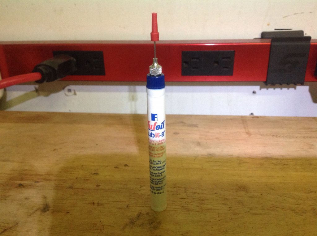

This is what I use it’s awesome spray all my joints never had a squeak.
