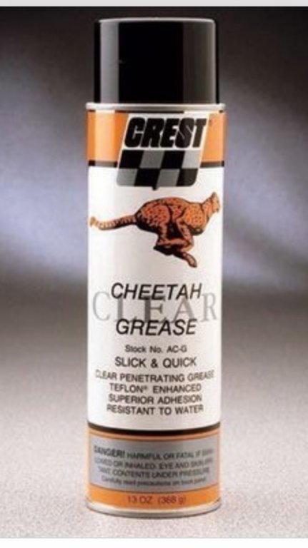

Where do you buy it?View attachment 144987
This is what I use it’s awesome spray all my joints never had a squeak.

I get it from we’re I work at a GM dealership. I will ask them tomorrow we’re they get it and let you know.Where do you buy it?

I asked they order it from co-auto, from what they told me you have to be a dealer and order by the case. You can try a local GM dealer and see If this helps any.Where do you buy it?
