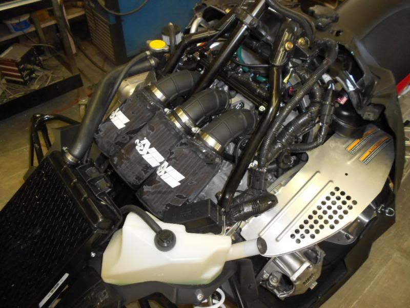

Allen, How much of a gain? PCV?? Thx

Any bog from idle?
WHat did you do with the sensor from the airbox that tells intake temperature?

Looks good, just like it did on my Nytro. It's not really a hp gain, unless you add PCV and exhaust. Together there might be 10-15 horse to be found. I'm seeing that that's what they are claiming just from the header. I find that hard to believe, but it would be nice. Adding just the filters is just bolt on and is not true hp. Bit it made my Nytro sound pretty cool. You can here the throttle bodies a lot better.

1050THMPR said:Allen, How much of a gain? PCV?? Thx
4-5 hp. No need for a PCV if the muffler is stock.
NOS-PRO said:Any bog from idle?
No bog from idle, although in any drag race function I wouldn't recommend leaving from idle, I would recommend leaving from just below clutch engagement.
Intake temp sensor gets zip tied to the wire harness.

The Viper is truly very restricted in the intake and muffler areas. With just a intake kit and free flowing muffler 10-12 hp can be gained, but for both items you will need a Power Commander V to help with fueling. For about $1350 you can pick up 10-12 hp and that would include intake, muffler modifications, Power Commander, and clutching.
The stock air box is very restrictive, you can drill a ton of holes, but there is still restriction and drilling holes can change the characteristics of the air flow through the air box as well. When you put our K&N filter kit on, the air intake is no longer the restriction, the restriction is the size of the throttle body itself. We learned this on the air flow bench when playing with different combinations.
sxr70001 said:Be interesting to see if this sled has the hard start problem with the air box removed and I assume the sensor relocated.
This sled never had a hard or no start problem in 500 miles so far, so unfortunately I can't tell you if it will change that or not.
