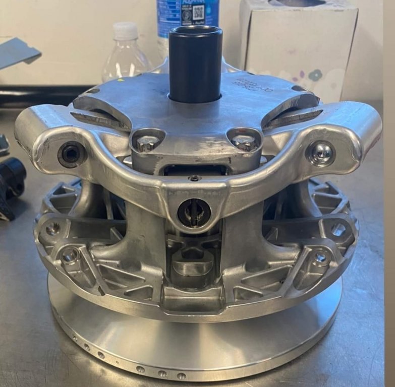

Any news on how this is working yet?
- Nov 11, 2016
- 548
- 961
- 1,018
- Cedarville, MI
- Cedarville, MI
The new Adapt clutch is working well and a lot of riders and racers like it. We have sold many clutch kits for the Thundercat and 8000 models.Any news on how this is working yet?
The new Adapt clutch uses way less weight than anticipated.
