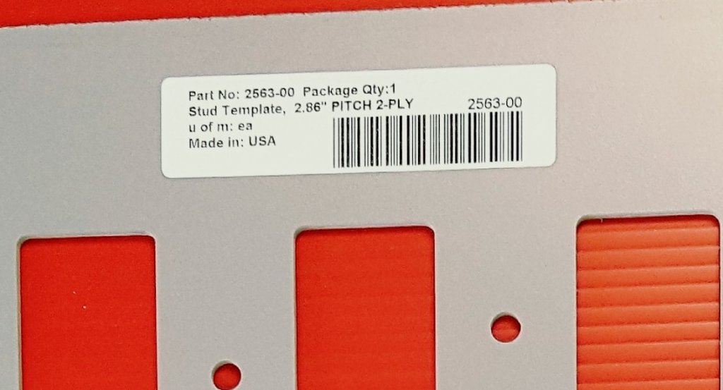

From what I am reading if you stud in middle just dont use middle protector and you will be fine? I never studded a sled before I want to try and save some money my dealer wants 1100.00 to do it. I was going to use the woodys gold diggers per their recommendations on there site with there 129 template staying away from the outside / quiet pads. Picture is of template with 129 track and quiet pad template

Was thinking of going with this one staying out of outside

I really like my 2/4/2/4 pattern, I like the template I got thru stud boy, its not cardboard like some of the cheap woody's templates.
I know it seems obvious, but I must have heard from dozens who actually studded in the center, then realized their studs would hit the center protector, so I just wanted to remind you about center.

Thanks Dan, I like the looks of that. I dont like copying people but I think I am going to go that route. You are using all 3 protectors I assume then with this set up?

Also is there a specific part number for that stud boy template?
Yes, and its a proper pattern that leaves exact amount of open center area, works well with the center protector.
