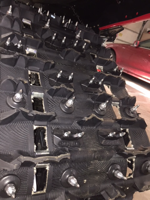

What do you sharpen your studs with?I even used some doubles on the outside band so I could get eight scratch lines on the outside bands and the fact that doubles hook sooo much better.
Was thinking I could remove ALL the outsides to get rid of some weight and get a little more track slippage. Hooks a bit too hard actually. Once a racer, always a racer I guess.

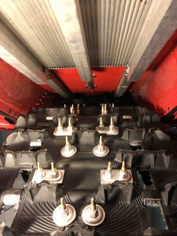

One other question I see in your photo the 3 heat exchanger protectors. You dont need the full tunnel protectors running all the way up?Yes, and its a proper pattern that leaves exact amount of open center area, works well with the center protector.

No, those are factory protectors from cat/yam(3 piece), they work well. The coolant "runners" that connect the coolant from rear cooler to front cooler only run over the track clips, so they are protecting the alum tunnel.One other question I see in your photo the 3 heat exchanger protectors. You dont need the full tunnel protectors running all the way up?

I know it seems obvious, but I must have heard from dozens who actually studded in the center, then realized their studs would hit the center protector, so I just wanted to remind you about center.
