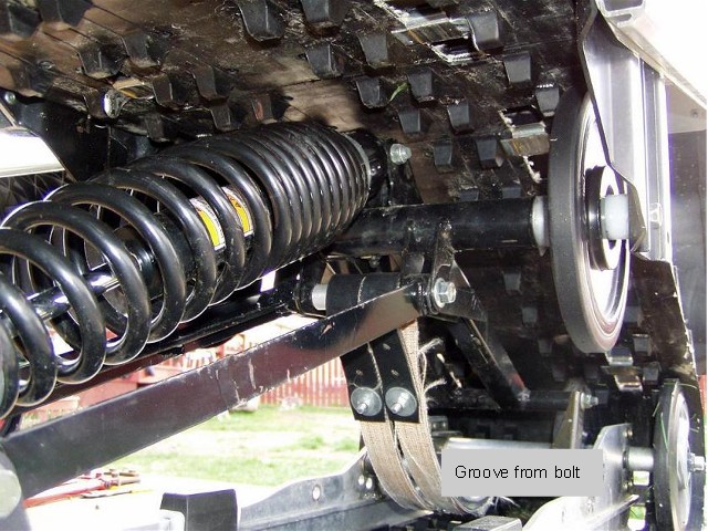

obr (and others) what is it exactly that sucks about the stock Apex skids? Do the bottom out hard? If this is the problem, you might want to take a close look at the rear scissor just ahead of your rear axles. On the stock RX-1 skids; Yamaha's design caused the bolt going through it to smack the top of the rail. I had my rear shock at full preload and still felt like I was bottoming out. I finally noticed the rails were getting a groove in them from the bolt hitting the tops of the rails right where the transfer control rods go through. After cutting them down 1/2 inch I can run my rear shock at full soft with no bottoming out. I weigh 280 lbs with full gear. Here's a picture of the rails after cut.

thanks man, great info, just the info I was looking for. Will check the skid out. That's just the problem you described. It bottoms out HARD...

Let me know what you find on that rear bolt. I'm thinking with the tipped rails you guys might be experiencing my same issue but worse because the rail have that little bit of a tip to them. In theory with the rails up more back ther and the travel remaining the same from the factory you Apex owners should feel that hash bottom when the bolt hits alot sooner. Here is a picture of the bolt before I cut it off even with the nut and you can just make out the mark on the top of my rail from the bolt (it looks like a white spot on the rail's inside edge right above the top right corner of the text box). Move your mouse pointer to the lower right coner and a box should appear which makes the picture expand to a larger size.

I looked at the sled, but couldn't see how the bolt could hit it in any way...

This is on my Apex Mountain. I have my weight transfer rods set up for full weight transfer and the anti-bottom rollers (just behind idler wheel) set up for medium in the picture. Also in the picture are MPI stainless steel ice scratchers (in front of idler wheel). This has been working for me, I'm 185lbs, and never "tail-land" the sled off jumps. It still bottoms occasionally when worked hard in big whoops but that just lets me know I'm using all the travel available. Transfer rod setup and the anti-bottom roller hole position make a big difference. If you have the weight transfer rods set up to couple early (nuts all the way up) the suspension gets stiffer and if you have the anti-bottom rollers in the hard position (front most rail position) the suspension gets stiffer.
