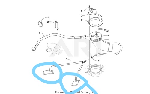

Where did you find the filters on the ends of the "Y" ?? I have a lead on the filter sock that connects to fuel pump, but those on the end of the Y ?View attachment 171384

Orielly for the pump strainer..![]()

They don't give those away!![]()

E bay has many diffrent vendors, brand was spiWhere did you find the filters on the ends of the "Y" ?? I have a lead on the filter sock that connects to fuel pump, but those on the end of the Y ?View attachment 171384

About sixty bucks earlier this year, 184 from cat.They don't give those away!

Yea I was thinking about replacing these after a few years.. Maybe by then they will be 100+ LOL.About sixty bucks earlier this year, 184 from cat.
