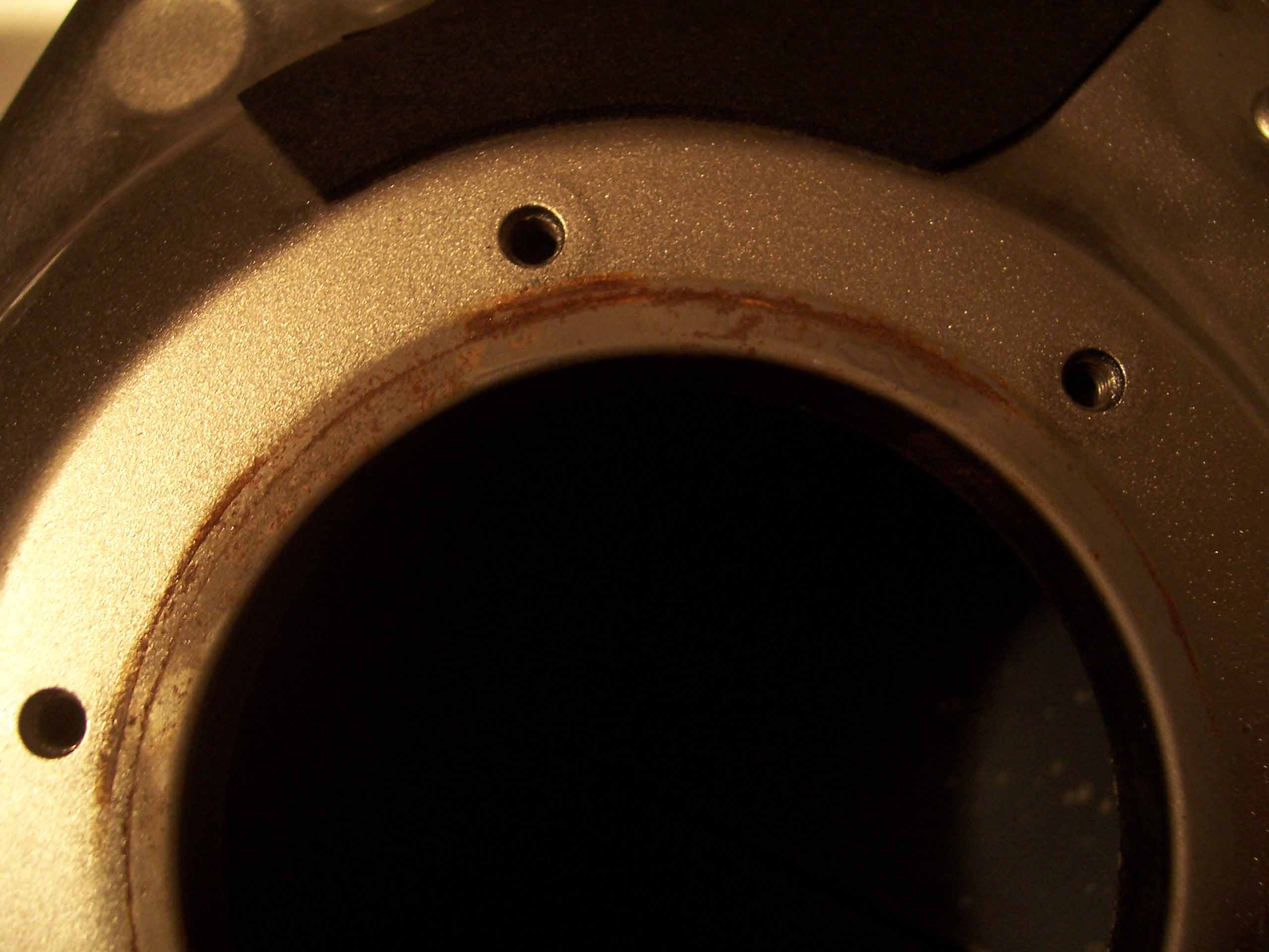

Sorry to hear that Yamaslob. From what I remember the o-ring was a snug fit on the fuel pump. I store my good stuff inside so I took a picture of my gas tank where the fuel pump bolts on. The brown rust looking area is where the o-ring sat. The pump had a lip on it that held the o-ring in place and the metal ring bolted into the holes and squished the lip of the fuel pump to the o-ring. They might be a different set up on the sled. Possible you need a new o-ring. Good luck and let us know how it turns out.
PS One thing to try if the o-ring is too big, put it in the freezer for a few minutes and see if it shrinks enough to stay on. I hate to see anyone lose seat time with the short season's, sorry I couldn't be more help.
