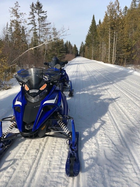

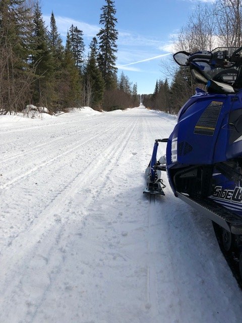

She’s been tough tested again this year with nothing but primary roller wear! This thing sees 120 and over, many many times daily, and the xs825 still looks new. It does take different clutch settings then the JP, but it is tough!
2 weeks in a row, it got tested many times on the County Trails, and passed with flying Blue colors! Ha Ha.
