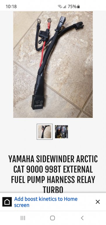

Anyone running a gss 342 with the stock fuel regulator? Any issues or is the regulator a must?

It’s not that hard to change. I will say that if you put in a bigger pump you really should put in a fuel pump relay and separate fuse that can handle more amperage. The stock relay is very small along with the wires.
On my viper the ISC fuse runs the fuel pump, and a host of engine sensors, not sure on the Sidewinder.
There really should be a separate fuel pump fuse anyway.
I installed this.

Got a link? And is this plug and play? Sits under the seat by battery I assume.View attachment 163662
I installed this.
