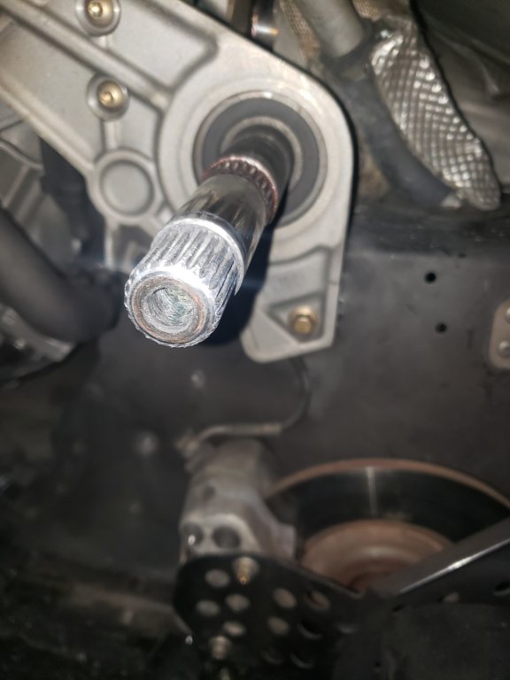

No they are differentDo these have a different spline than the Winders?

How about that...wow. Had it always been well greased?You gave me the kick in the a$$ I needed....hahahahah

Lightly greasedHow about that...wow. Had it always been well greased?

This was partially my fault...The next weak link?
This is a cat jackshaft imo yamaha's spline looks like a better option
Let us know what shaft you upgrade to.
I was attempting to try and make my new stm 3wsp primary clutch to work with oem team secondary.
The oem team secondary does not have a belt deflection adjustment due to the roller bearing on the shaft of the primary to run a really tight belt.
I bought a adjuster bolt and drilled and tapped a hole for deflection in the same location as previous cat oem secondaries.
Sled was running awsome for 1000km and was loving the primary it really gripped the belt....
The next weekend got together with some good friends for a ride and we got on a lake and start racing our sleds back and forth on the lake on our 300 header tunes.. my sled was working awsome. We continued ride and I had a slight vibration (thought is was from the added studs to outside of track....) we kept going everthing was fine. The last day we rode i launched my sled and when I landed I knew right away I f#%ked it so I turn back.
Found a used secondary locally a few days later on I was back on the trail. In my head I said I was going to take it easy because I knew the spline on the shaft was buggered a bit.
Well here goes Marc acting like a 21 year old again... and I launched Off another knoll and landed and stripped her good ...lol
Something I overlookedwhen I looking at options with oem secondary was the fact that the spline on the oem cat secondary is only casted in the aluminum and not a steel spline insert.

Working on it!! getting a shaft and stm secondary
