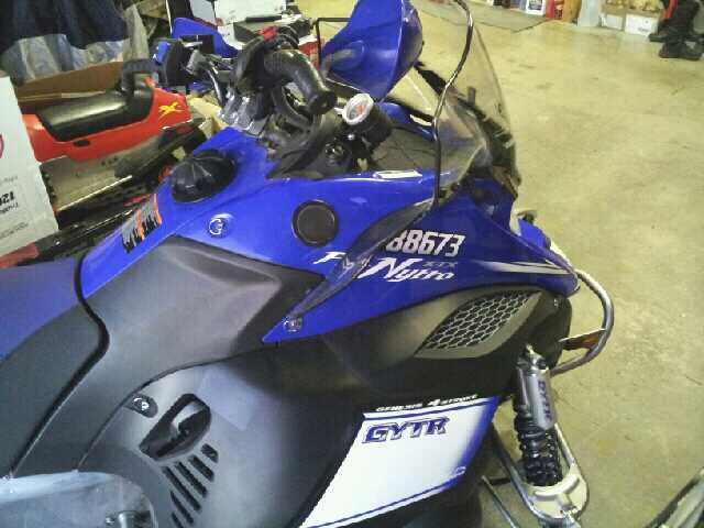

Roest Vent Kit may help...I have a 2012 XTX and had the light come on a few times only when idling (for some time). Soon as I took off and hit some loose snow no light...
