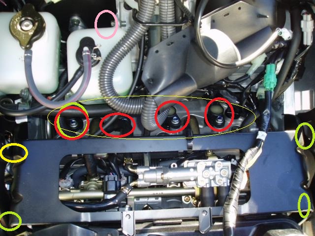

Sparkplugs are under the caps that are held in with a silver 10mm bolt. Remove the bolt and unplug the cap/coil. You will need to twist and pull upwards to get the cap/coil off. Sometimes I use a pry bar to get them buggers off sometimes.Thanks for the instructions on changing your spark plugs. I'm new to this so I'm just going to ask that under those 4 bolts with the blue dots are spark plugs under the headlamp pod? So you just unbolt the top and then use the spark plug removal tool?
To add to the link with the instructions posted if you remove the steel bracket that holds the headlight pod on and the over flow tank it will give you more room to work.
Red is the coils
Yellow is the 4 10mm bolts holding the bracket
Pink is the 10mm bolt for the over flow tank
If you use a good quality sparkplug socket it will have a rubber grommet inside to hold the plug. This grommet does 2 things. First it protects the ceramic from getting broken or cracked while remove the plug and Second it will hold onto the plug so you can remove it form the engine. A short piece of rubber hose that fits on the tip of the sparkplug tip also works well for install and removing the plug. A wobble extension or a swivel for an extension makes this job a lot easier.
