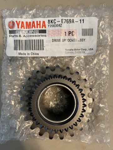

I ordered a new top gear for my '20 LE and this is what came. Bushing and gear have three oil passages lined up, drilled all the way through. I don't have my sled opened up yet so I don't know what my current bushing looks like. Only have ~500 miles on it, but I'm going to follow the Fleecer et al. method and just change it out each season anyway!

Be sure to take a look- When I changed mine the new gear had plenty of filings in the hole , there were burrs also on the inside of the bushing.

That looks to be the newest gear drilled on an angle towards the outer edge of the bushing.
