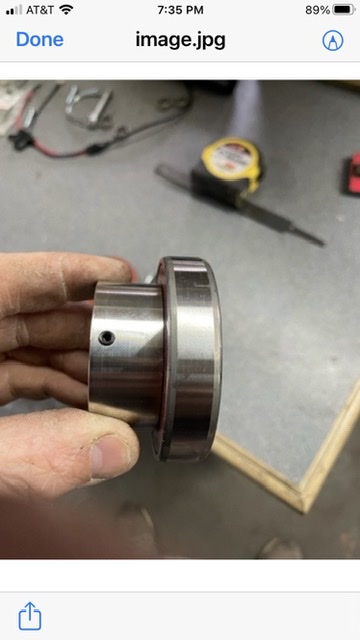

The updated lower driveshaft repair kit is a must on a new or used sidewinder.The updated bearing has a collar that is pressed in to the bearing I.D. and has 3 Allen screws to lock to the lower shaft.$160, this should be added to the list of fixes.They are available @ Barn of Parts,or call Travis during buisness hours @717-821-9639

Another GREAT Design from Travis at Barn Of Parts!!!! https://barnofparts.com/The updated lower driveshaft repair kit is a must on a new or used sidewinder.The updated bearing has a collar that is pressed in to the bearing I.D. and has 3 Allen screws to lock to the lower shaft.$160, this should be added to the list of fixes.They are available @ Barn of Parts,or call Travis during buisness hours @717-821-9639

Is this applicable to the Thundercats as well?The updated lower driveshaft repair kit is a must on a new or used sidewinder.The updated bearing has a collar that is pressed in to the bearing I.D. and has 3 Allen screws to lock to the lower shaft.$160, this should be added to the list of fixes.They are available @ Barn of Parts,or call Travis during buisness hours @717-821-9639

Yes,thread #19 has all necessary info for a long term fixIs this applicable to the Thundercats as well?
