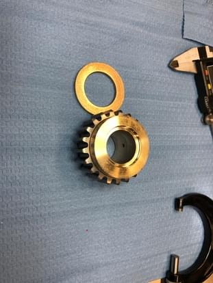

Thank you, Our Proven DMC gear with heavy duty bushing is back in stock and available on ebay.
Our design offers 50% more bearing area to support the load. We have several test sleds and customer sleds with over 5K miles and zero failures.
We also offer the brass shift fork pads.
