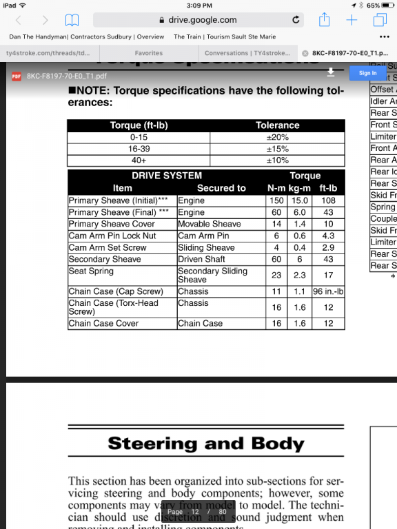

Can anybody give me the proper torque spec on the main primary clutch bolt , I believe its a 22 mm head . also the six ten mm head bolts for the cover . Now for the secondary main bolt and the three helix nuts .

The primary clutch bolt is 108 ft lbs then loosen nut and torque to 43 Ft lbs. the secondary bolt is also 43 ft lbs.Can anybody give me the proper torque spec on the main primary clutch bolt , I believe its a 22 mm head . also the six ten mm head bolts for the cover . Now for the secondary main bolt and the three helix nuts .

Primary bolt torque to 108ft/lbs, loosen and retorque to 43ft/lbs. Secondary torque 43ft/lbs.

Thats awsome thank you so muchView attachment 133300
