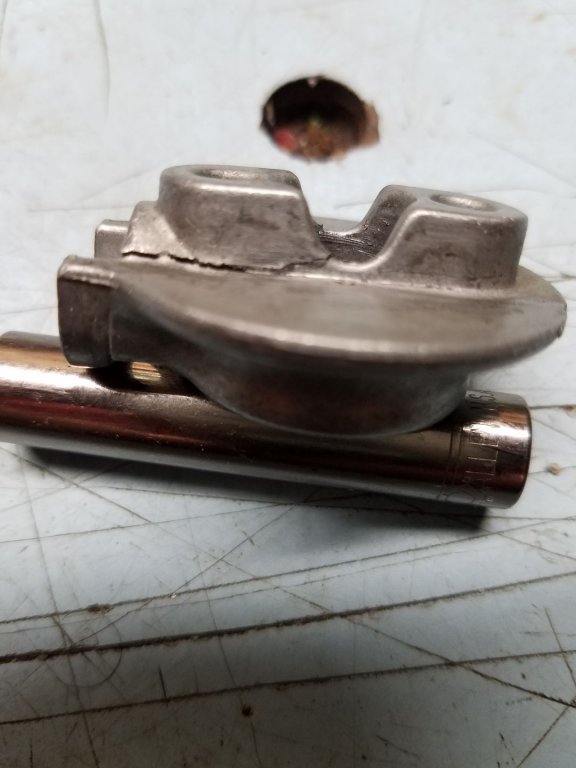

Just more reinforcement - check your track adjusters when doing maintenance. Of the 5 TCats I've serviced in the last 3-4 weeks ALL had broken adjusters. Lots of previous threads on this. Grip-N-Rip has the billet ones that won't break.

one of the reasons I bought this new forth wheel kit this year heard a lot of people cracking them.

Those look a lot like my larsons kit,the adjuster is also relocated to the outside,most of the reason I bought them,just because of the crapy cat designed adjusters,mine were all split and ready to come apart.View attachment 150990

I have not had any problem with my stock adjusters used with my Stealth 4 wheel kit, but my buddy with his stock set up had to replace his last year because both of them cracked, so I shall keep an eye out for that also!

After I fought with these stock cat adjusters stock and yet one more set that failed,thats when I bit the bullet and bought the larson kit,man its almost overbuilt,but better than underbuilt,no problems so far,it now has about 2000 miles on it.Yes they are I’m really impressed with this kit they did a nice job

Most people don't know that JT Trihub and Stealth kits push against the outer diameter of the stock adjuster and pushes the adjuster adjuster directly against the rail. The stock axle push at the center bottom of hole and stresses the cast adjuster.

If you are talking about the 1/2" Barn of Parts solid axle, yes, it fits through the slots fine, but you have to drill out the adjusters. That's why I recommend using a replacement adjuster such as the Grip n Rip.That axle fits through the slots?
