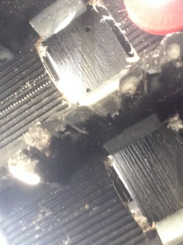

View attachment 117898 I never realized the inserts were so hard to see .
I guess the holes help to lubricate and cool , when they fill up with snow and water .
2011 skid is different then the 12 up from what I read. They moved the wheels down on the 12 and re-positioned them. So same rails but different wheel holes. You can buy the larger wheels and might get to stock 2012 wheel depth on the rail. New slides the wheels can be turned when the sled sits on the floor in the shop.
