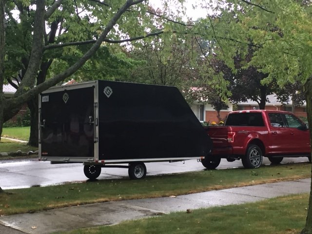

I will say the look of my axle is more reward as compared to my old trailer. This one tows so nice you don't even know it is back there. Of course the EcoBoost pulls it effortlessly.
