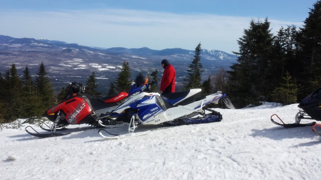

How do these Curves work off trail? Do they give you more flotation than the tuners? How many carbides do they have? Are you using a 6" shaper like I am? What is the width compared to the tuner?Put on a set of curves. Rode yesterday in Temps in the mid to high 50s. Obviously the snow was soft and loose. The curves worked great. I could ride as hard into the corners as I could on hard pack. I'm sure the other brands mentioned work great too. I'm very happy.
Now I just need a bit more transfer. I read a lot of post with people fighting to keep the skis on the ground. Mine is just the opposite. I can't get them to lift when I need to. View attachment 107832View attachment 107833

The curves are kind of an hourglass shape. They are wider than the tuners and float better than the tuners. I'm using the trail version they also have a mountain version for more floatation. They use a single carbide. I got their 6 inch carbide because they didn't have shapers in stock and I paid for overnight shipping for a trip the next day. I wasn't paying overnight to two separate vendors. Their carbides actually worked really well. Time will tell how they hold up.
