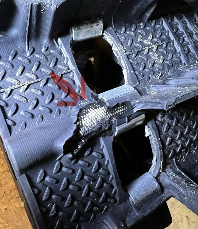

6K on track and tore a lug. Ride in very good conditions northern Maine and Quebec on a N.A. SR-Viper. I seen in the row my lug tore, the top belt is almost showing. And showing cords on the inside of the track. Just seems poor quality to me, but could be wrong. Going to put E6000 in the torn area and hope it’s good for a while.

Did you put screw in studs in that track or is it a ice series track? Thats the drawback to these longer lugged tracks with the studs in the tips of the lugs, it makes life harder on the lugs and rips them off eventually.
I'd say that track is done. Its going to continue throwing lugs. Better hope it doesn't take the whole thing out or a section of it or you'll be putting in a new tunnel and maybe exchangers if it ballons or tears it up under there. I'd be changing that track out rather quickly if it were mine.
