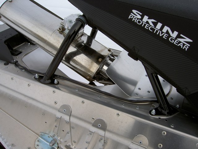

Alatalo said:Any possibility to use the block-off plate included in the Skinz seat kit...?
If not, you will likely have to make your own block-off plate.
I made my own for the combination of Skinz seat and Excell full exhaust.
I like the look of that...what excell is that and is the hangar pictured which looks bolted to the seatframe from skinz or?
That is not the Skinz exhaust mount. They come set up to take a factory style mount.

I figured that...I want to know how he did that as Im considering the same

sj said:I like the look of that...what excell is that and is the hangar pictured which looks bolted to the seatframe from skinz or?
That is the Excell full exhaust with the Excell silencer clamp and bracket, in the position where they would end up if using the standard seat and heat shield. On top of this is a small, home made bracket. This bracket holds two clamps that attaches the entire assembly to the seat frame. A little bit too bulky and prototypish for my liking, but I will not invest more time in this particular bracket since I will replace the entire silencer with something lighter anyway...

I like it...and the tunnel bracing as well..
I am doing up an xtx and might take a page from your book....
