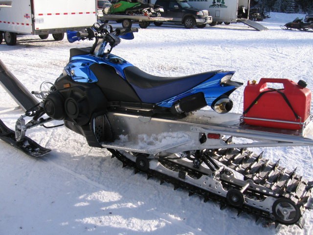

Here's a pix of what i have done so far. Going to use another hose or length of pipe with a 90 on the end to run it back past the seat and then up. I am also extending the muffler outlet a little to get it down into the tunnel more.
