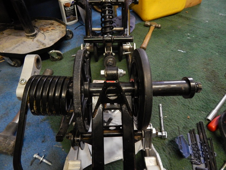

I can't figure out how to get to these wheels. Mine both need replaced, but I can't get the silver colored piece off. I grabbed a pic from another post, it's the piece he has off the right, but still on the left. I pulled out the Allen bolt, but even smacking with a hammer I can't get those off.

They're seized to the shaft. Use a good penetrating fluid and after they sit for a day you can use a heat gun to warm and expand the aluminum arm. Should come off with some patients. Make sure you install in the same position.
If they are a really pain in that a$$ you could use a two jaw puller with a socket the same diameter at the shaft. Use the socket so the shaft of the puller has something to push on.

Getting the upper idlers off is much easier with the rear skid out of the sled. I had seized bearings with the spoker crap wheels turning on the bearing. Replaced them with solid black wheels. No trick to getting them off. Just whack em with a hammer after spraying some penetrant on them. They'll come free eventually. I agree the bushings are crappy. I only wish they made an oilite to fix these. I took the idler off first so I was just striking the bearing itself. The circlips are on the inside (naturally) and they are a bit of a pain to get at with the shock installed.

You could try to wedge a punch in the slit of the aluminum piece to try and spread it a bit, otherwise a 3 jaw puller with a socket against the shaft should work. And for a better full rubber wheel to prevent flat spotting, look at this thread:
