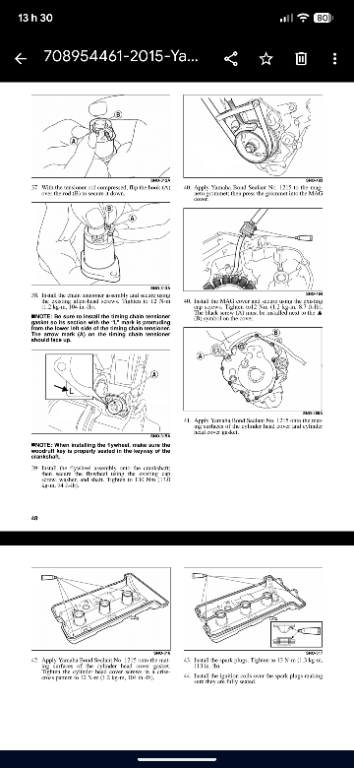

Can't wait to see those pictures! Will you try the fastest more risky or longest way to do it? Btw, I'm currently doing my 1st ever and next will be doing my wife's! Quick inquiry here, what's the sealant type used for gasket cover? Do you even apply some? Also, here's my sheet. Wayyyy off the specs...with cold starting issues!I am doing another one in a few days so my memory will be fresh and I will take some pics. Can for sure give you any help you need to make a Video.

I used a dab of Yamabond sealer at the corners of the crescent seals on the valve cover gasket. This is pretty good stuff and I've had this tube for going on 20 years. It's still good as new and works perfectly.

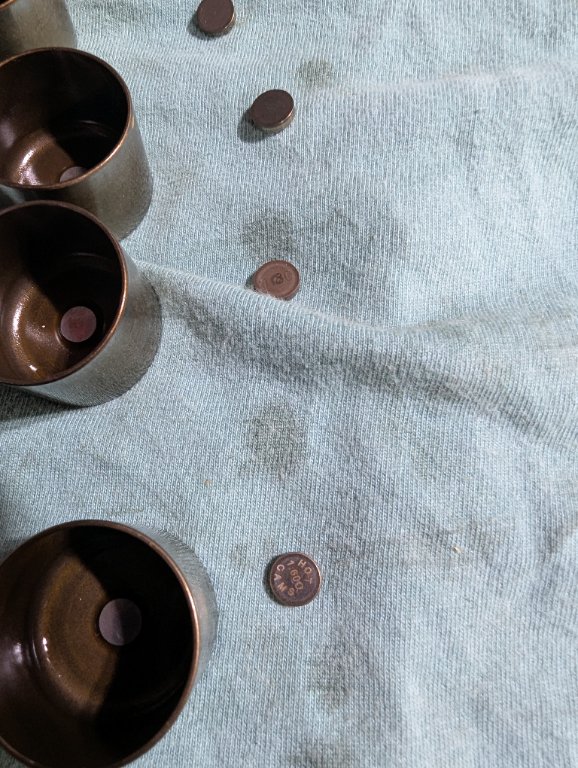

Quick update on my end: after disassembling my 2016, I noticed some hot cam shims, so it had indeed been done once before (first 4 pics). I also did my wife's 2015 which has a little more than 15k and was not better than mine! Beware of the little coolant hose under motor mounts may leak at the joint clamp to the rad when warming (on the left side). Just verify and tight it if needed.
