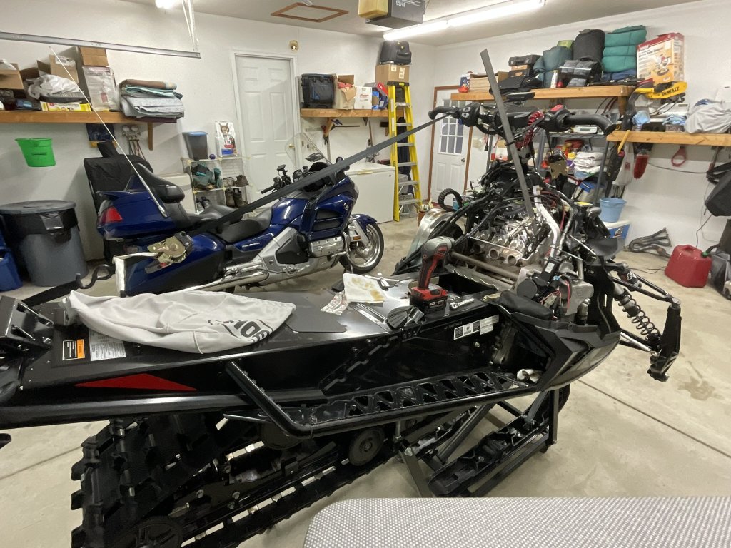

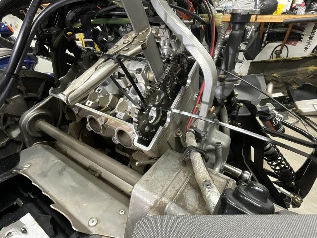

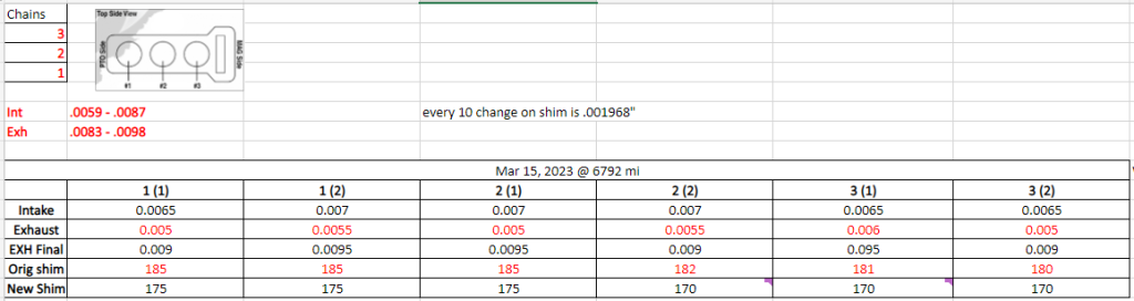

Add another one to the list that had exhaust valves under spec. with far less than 25k miles on the clock. I only had 6800 miles, but based on everyone else's findings in this thread, I still thought it would be a good idea to check them. I did use the flat steel bar (1/8"x1"x36") method mentioned in another post on this thread, but I put it on the PTO side of the chain and gears rather than the Mag side as it seemed more secure and less likely the bar would slip off the intake cam gear bolt that would be used for leverage. With this method, the bar sits nicely in a pocket between the intake cam gear and right most holder for the cam.
I used 2 ratchet straps - one on the left handlebar to the rear bumper to keep the bars from turning, and a second one that ran from the flat bar putting pressure on the cam chain guide over the right side of the handlebar and secured to the engine cradle (aribox removed). This end could just as easily have been secured to the front bumper and there would be no need to remove the airbox.
I also took the header and heat shield off to replace a couple loose rivets that were under it, but this would not need to be removed otherwise.
Here are my results and a couple pictures showing the straps.
